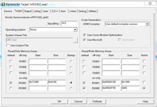

i can't find the right settings for the bootloader i am using s130 softdevice and sdk10 can someone help?
The correct linker configuration depends on which package variant you are using. The default configuration is for the xxAC variant that has 256K of flash and 32K of RAM.
Default:
xxAA (256/16):
xxAB (128/16). Note: BOOTLOADER_REGION_START must be changed to reflect new start address
