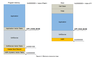

    You can upload hex images using 'drag&drop'. Problem is that you can only program one hex file as flash is erased when a new .hex image is uploaded, even if they're linked to separate regions in flash. You can merge the softdevice and application to work around this limitation, but I think it's easier to just use the CLI tools.
    Merged softdevice and ble_app_uart example with BLE event length set to 6 *1.25 ms:
    uart_w_s140_v5.hex
    Memory layout for applications that use Softdevice:
