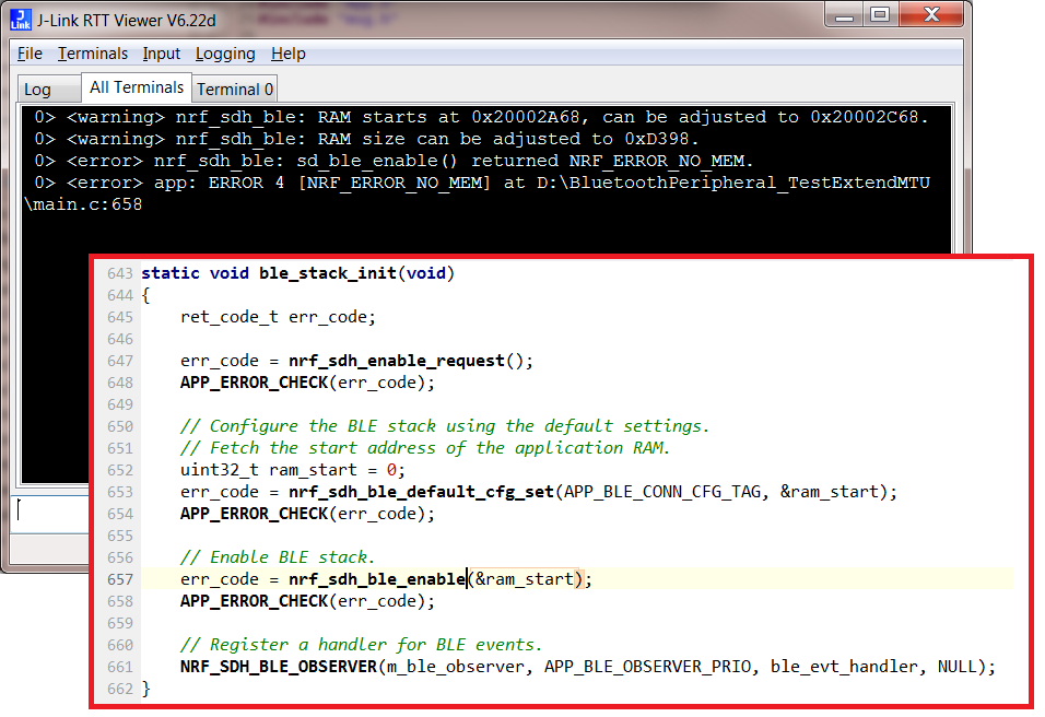

  • I try to extend the MTU size and get the next prints:
    : Trying to set length
    -max_rx_octest: 251
    -max_tx_octets: 251
    sd_ble_gap_data_length_update() (request) on connection 0x0 returned unexpected value 0x13.
    Error NRF_ERROR_RESOURCES
    -tx_payload_limited_octets: 101
    -rx_payload_limited_octets: 101
    What is payload? Is it L2CAP+OpCode+AttributeHandle+AttPayload or just AttPayload?
    Why the payload is limited to 101 bytes?

  • You will likely need to adjust NRF_SDH_BLE_GAP_EVENT_LENGTH = 5 (or more) to allow longer packets, because this will reserve more time for the radio event. I expect '101' message you get to be the max with NRF_SDH_BLE_GAP_EVENT_LENGTH = 3.  Also, with max octets = 251 the max used by the application is 247, the remaining 4 is L2CAP header.
