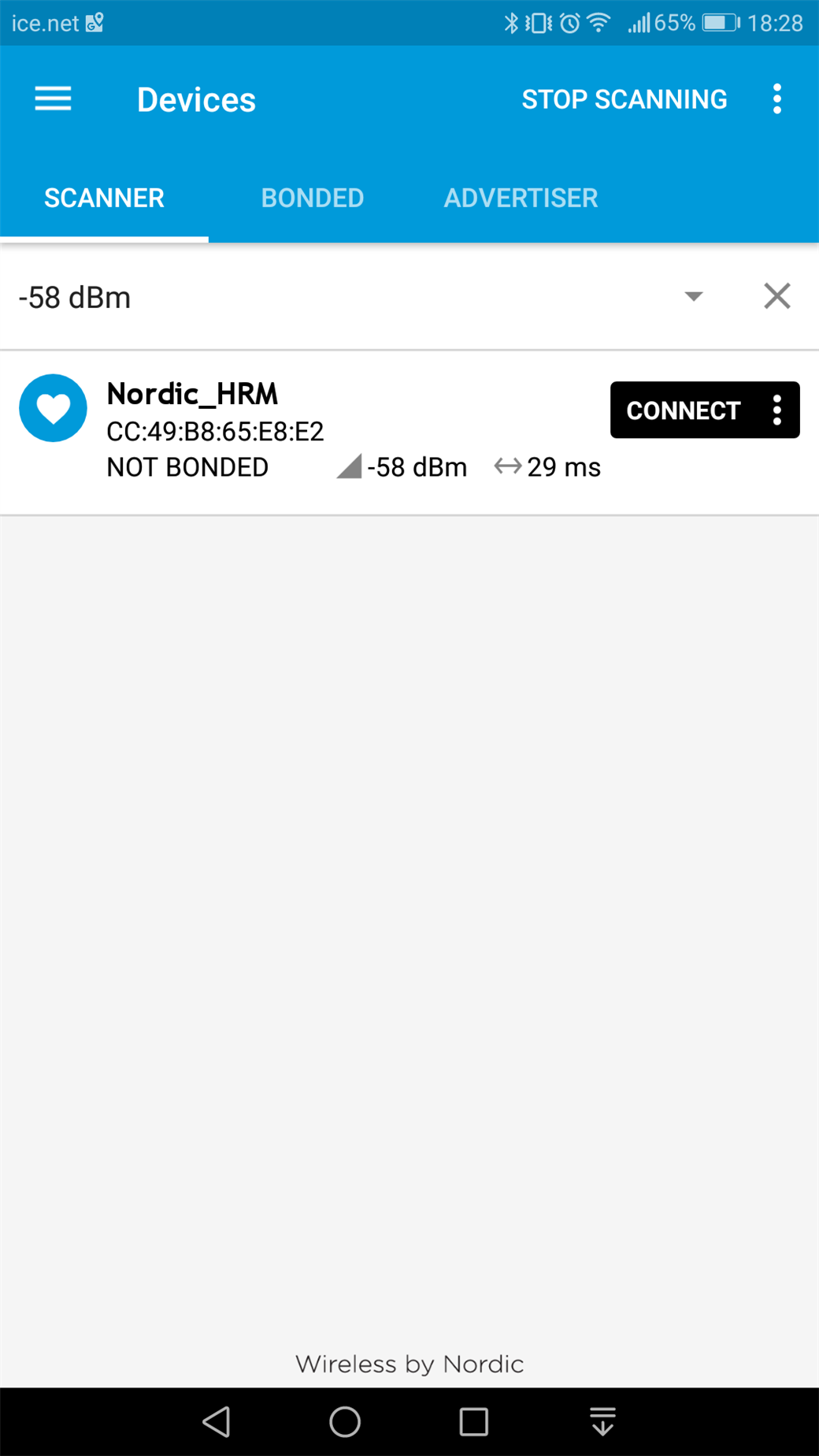

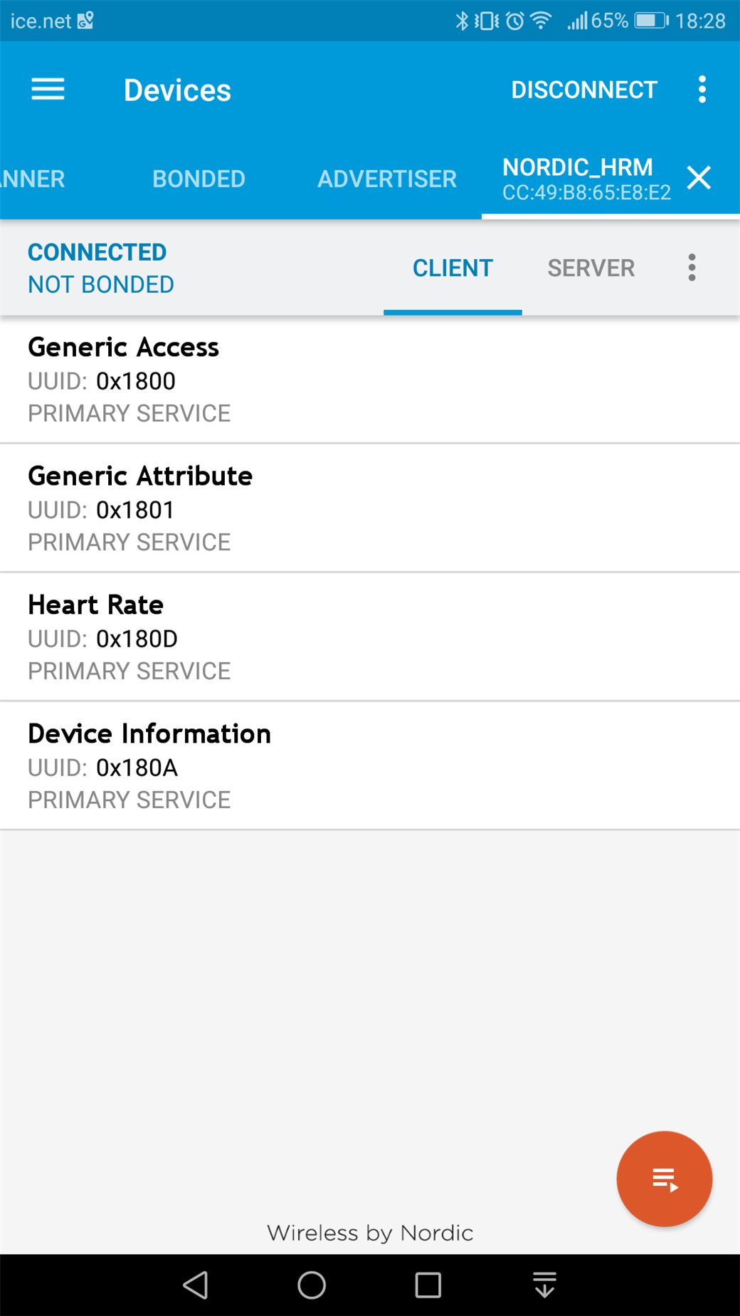

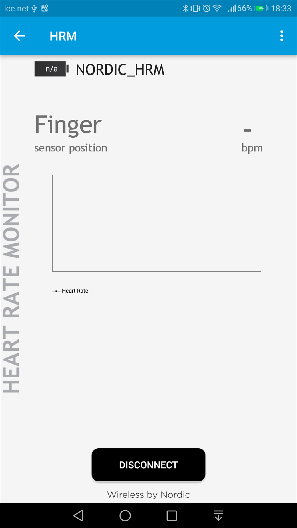

    I downloaded a clean copy of the nRF5 SDK 14.2.0 and ran the ble_ant_app_hrm and experimental_ant_ble examples and it works as intended. See screenshots below from nrRF Connect and nRF Toolbox where I am able to connect and discover services as intended.
    Try redoing the whole process step by step. Is there anything you may be doing differently than described in the documentation?
