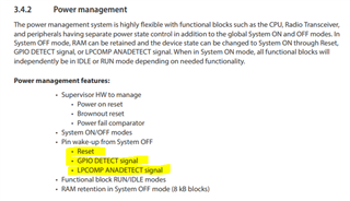

Hi, is it possible for the 824 chip to sleep until woken up by the Bluetooth of a nearby device that wants to connect/pair with it? And what would be the current consumption in this case?

Here it sounds to me that you are talking about "Wake on BLE" which unfortunately the nRF51824 does not support.
Snippet from the Product Specification:
