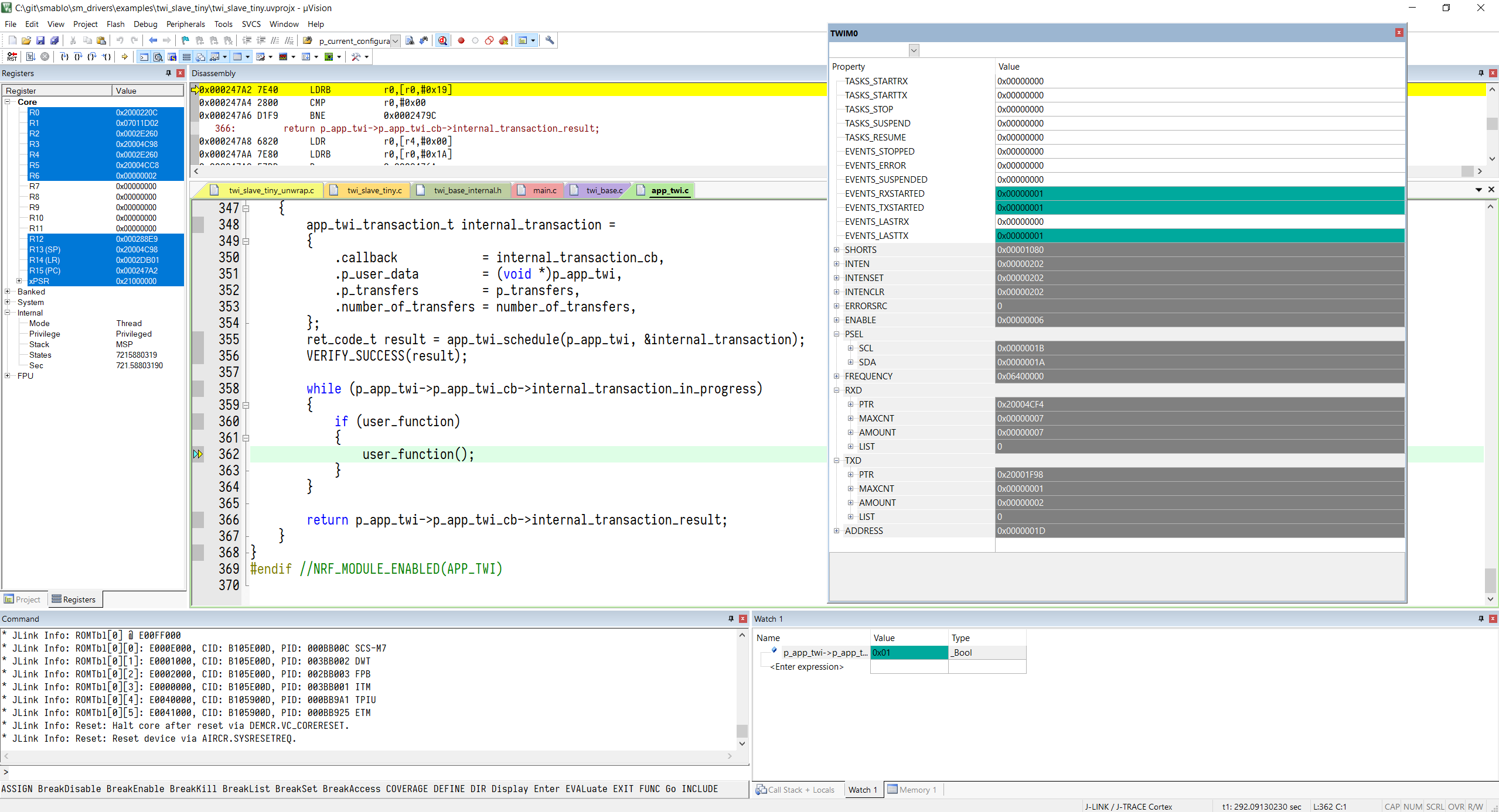

I'm investigating series of seemingly random hangs when app_twi gets permanently stuck in app_twi.c following code snippet:
while (p_app_twi->p_app_twi_cb->internal_transaction_in_progress)
if (user_function)
user_function();
When this happens SCL line is permanently pulled low. I thought that it may be due to clock stretching and checked if one of slave devices is misbehaving. I wasn't able to to find anything on slave side.
One of my slave devices (Atmel Tiny MCU) has a way to tell if it's holding SCL line. While similar lock happened I was able to check that SCL was held by master (as far as you can trust ATTiny register values). I was also able to reset the slave and this haven't released SCL. However resetting nRF52 (master) caused SCL release.
So I think that's something wrong with app_twi master implemetation.

test_case(1) works as expected while test_case(0) reliably causes app_twi to get stuck as on attached Saleae trace /cfs-file/__key/support-attachments/beef5d1b77644c448dabff31668f3a47-010a9164018145d884c8f96862005e33/twi_5F00_hang.logicdata and register view screenshot
While this happens SCL is permanently pulled low. Resetting nRF52 gets communication working again.
