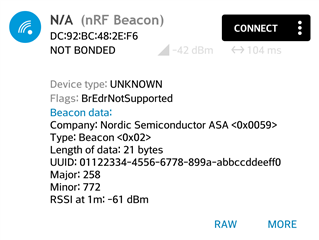

  • I have compiled and uploaded the "ble_app_beacon" example in the Nordic nRF52 DK and it seemed to work fine, but then, I changed some data in the beacon to check if the changes had effect and they did not.
    After the changes, I obviously saved, cleaned the project, compiled again and uploaded the new file to the board. I also refreshed the app, restarted the board,... I changed the "major" and "minor" fields, but it keeps displaying the default ones.
    Does anyone know why is this happening?
    I do not post the code here because is the original one, the only change was "major" and "minor" fields.
    PS: I also tried changing the company field, the UUID,... nothing changes in the advertising packet.
  • Hi Ander,
    for changing major and minor value change the following #define in main.c
    #define APP_MAJOR_VALUE 0x01,0x02 /**< Major value used to identify Beacons. */
    #define APP_MINOR_VALUE 0x03, 0x04 /**< Minor value used to identify Beacons. */
    same for all the values which u need to change. UUID and company field.
