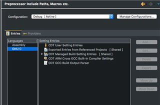

I'm getting an error in Eclipse that makes it unable to find standard libraries and definitions, therefore showing literally thousands of errors with things like uint8_t and such.
I noticed this error in the problems tab:
Description Resource Path Location Type
Program "${cross_prefix}${cross_c}${cross_suffix}" not found in PATH unleashed_nordic Project Properties, C++ Preprocessor Include.../Providers, [CDT GCC Built-in Compiler Settings] options C/C++ Scanner Discovery Problem
It would be very helpful if anyone has any clue about the meaning of that error.
Thanks in advance!
EDIT: The project compiles without a problem, and I know this is just an aesthetic issue, but it's really distracting and it makes it difficult to find errors that are actually errors.
EDIT: Added screenshot of the preprocessor include providers for reference.

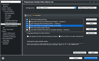

    The error seems to related to the CDT GCC Built-in Compiler Settings provider, which shouldn't be used when cross compiling for ARM targets. Do you have this provider enabled in your project settings?
    Include paths to standard libraries should be added automatically once you enabled CDT ARM Cross Built-in Compiler settings (provided by GNU MCU Eclipse plugin), but noticed a slight difference in the naming compared to what I have here:  CDT ARM Cross Built-in Compiler settings vs CDT GCC Built-in Compiler settings Cross ARM. Are you using the same plug-in? Suggest to enable the other provider and see if you get the same result (CDT Cross GCC Built-in Compiler Settings).
    Also, try to select the device in the settings tab. Note: Nordic device family must be installed to make device selection available.
    Include folder should appear when the provider is configured correctly:

    My problem is in fact that, in this project, the entries don't get discovered by the provider (in the bootloader project, the CDT ARM Cross GCC Built-in Compiler settings have lots of entries):
    EDIT: I have already modified the provider commands as instructed in the tutorial -> (.*gcc)|(.*[gc]\+\+) for the Output parser and arm-none-eabi-gcc ${FLAGS} ${cross_toolchain_flags} -E -P -v -dD "${INPUTS}" for the Built-in Compiler settings.

    I have experienced a few cases where the projects settings had to be reset back to the default configuration to make the built-in compiler settings work, but have not been able to find the root cause.
    Have you tried to enable the CDT Cross GCC Built-in Compiler settings provider instead of CDT ARM Cross GCC Built-in Compiler Settings?  I would suggest to restore project properties back to default, then re-apply the configuration used in the working project if you get the same result with  CDT Cross GCC Built-in Compiler settings.

    thanks for your suggestion! It got fixed!
    The exact steps I followed, in case anyone else has this problem, were:
    • Go to Project Properties -> C/C++ General -> Preprocessor and Include Paths
    • In the Entries tab, choose GNU C, restore defaults and apply
    • In the Providers tab, restore defaults, apply and close
    • Clean and compile the project
    • In the Providers tab, uncheck CDT ARM Cross GCC Built-In Compiler Settings, apply
    • Check CDT GCC Build Output Parser and change the command to (.*gcc)|(.*[gc]\+\+), apply
    • Check CDT GCC Built-In Compiler Settings and change ${COMMAND} for arm-none-eabi-gcc, apply and close
    After that, all the entries were discovered and my problem was gone :D Thanks again for your help!
