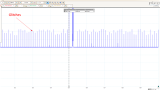

I am using the NRF52832 for advertising every 10s.
However while entering the sleep phase, I noticed some glitches while measuring the current. You can find attached our measurements using a picoscope.
What are these glitches due to?
In addition to this, in sunlight the density of these glitches increases thus increasing the current consumption.
While including these glitches to our current measurements, the value is equal to 7µA which is quite high. Do you know if and how this current can be reduced?
Thank you
