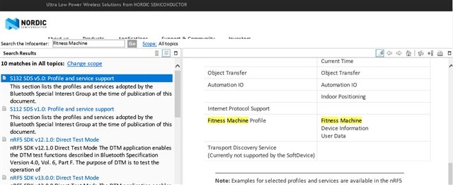

I find that Fitness Machine Profile is noted to be supported in this page :http://infocenter.nordicsemi.com/index.jsp?topic=%2Fcom.nordic.infocenter.sdk%2Fdita%2Fsdk%2Fnrf5_sdk.html
How can I get the example code for FTMP just like other ble services example codes supplied in SDK ?

    The link you sent does not lead to anything fitness machine profile related unfortunately. I have been unable to find any example related to FTMP in the Nordic SDK or on the infocenter. The only link I found was on the Bluetooth SIG website here. Could you send me the link you were referring to please?

  • Hi  Bjorn:
    I can find "Fitness Machine Profile" in Nordic Documentation.
    I can't find any example related to FTMP in the Nordic SDK too.

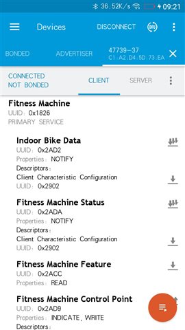

    Currently,I am developing FTMP profile code refer to CSC profile source code in SDK 13.1,NRF528332.
    As Nrf_connet doesn't  recognize Fitness Machine . Can you give me some information about products/apps  support Fitness Machine profile?

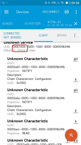

    For now , I have developed FTMP profile  for several days refer to CSC source code.
    Shown below:
    But it's not able to test for Nrf_connect can not recognize FTMP .
    So if you can , give me some help to develop FTMP.
  • You've probably noticed that the three advertised UUIDs in the Cycling Speed & Cadence example are defined in main.c:
    static ble_uuid_t m_adv_uuids[] =                                                   /**< Universally unique service identifiers. */
        {BLE_UUID_CYCLING_SPEED_AND_CADENCE,  BLE_UUID_TYPE_BLE},
        {BLE_UUID_BATTERY_SERVICE,            BLE_UUID_TYPE_BLE},
        {BLE_UUID_DEVICE_INFORMATION_SERVICE, BLE_UUID_TYPE_BLE}
    The UUID values for these three & other services are defined in ble_srv_common.h. For the battery service, you can see that the function BLE_UUID_BLE_ASSIGN() is called in ble_bas.c to add the battery service. Below that function call, sd_ble_gatts_service_add() is called, which adds the service declaration to the attribute table. The same applies for the cycling speed & cadence service & I am guessing the last service too. I am referring to the SDK 14.2 example. Basically, if I were you, I would take a look at how the example defines & adds the characteristics & services to make it appear correctly in nrf connect & essentially just copy the same format, but with your FTMP service instead.
    May I ask why you are using SDK 13.1 & not the latest 14.2 SDK on the nrf52832?
    I have searched to find the UUID value for the FTMP, but I was unfortunately unable to find this (see the defines under UUID_SERVICES Service UUID definitions in the ble_srv_common.h header file). You will need to find the correct UUID value. Once you have that, you should be able to refer to the above to easily make the characteristic become known. Hope that helps!
