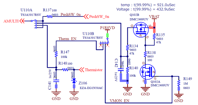

For one Pin, Digital input and analog input as 2 Channel.
As in the circuit diagram attached where the pin resource is insufficient
For one Pin (AMULTI), I design gpio for Button and analog input as 2channel.
(This switch uses the multiplexer of the analog input.)
So, there are items to be checked as follows
Please, confirm.
1) Can it be possible to switch between Digital input (Button) and Analog input dynamically?
   ★ Looking at "Figure 21: GPIO Port and the GPIO pin details" of document (nRF 52832 _ PS _ v 1.4. Pdf).
        I think that Digital input and Analog input can be switched by "ANAEN", but There was no item corresponding to "ANAEN" in the register.
2) Please tell me the way that No.1) can be realized.
3) Is it possible to perform SAADC while switching 2 analog analog input (from Analog Multiplexer) for one Pin?
4) resource Is there any way to solve this issue (* 2) while it is not enough?
   (* 2) For one Pin (AMULTI), gpio for Button and analog input as 2 Channel.
