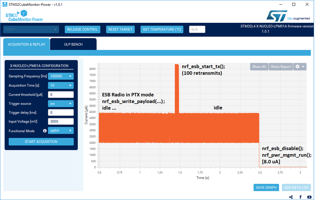

Higher current draw in System On low-power mode after ESB PTX than after ESB PRX
Dear All,
while evaluating low-power options in the context of wireless sensors, I've stumbled upon a strange behavior with the nRF52832 using ESB from SDK 14.2. Here's the outline of my test code:

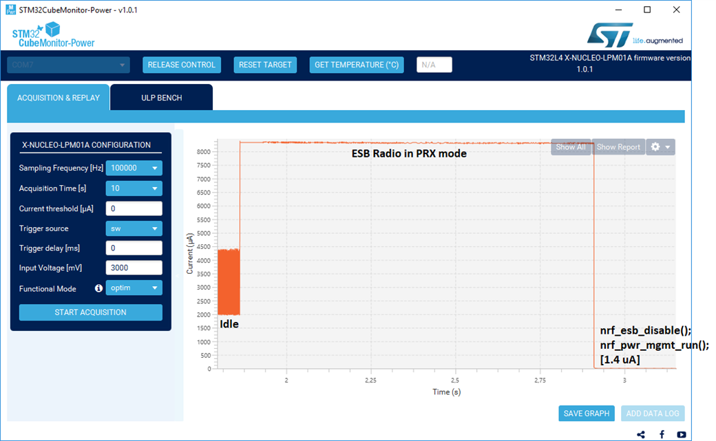

The last few lines put the system into System On low-power mode, and that's where it becomes interesting. It seems if I use the radio in RX mode and then disable it, the system draws about 1.4 µA (3V) current, whereas if I use the radio in TX mode and then disable it, the current drawn is about 8 µA. I briefly looked into the ESB implementation, but I can't find the bug (if any). Here two graphs showing the problem:
Things I tried:
  • disabling all interrupts manually right after the nrf_esb_disable() call --> no difference;
  • manually releasing PPI channels that may have been left configired by ESB --> no difference;
  • setting m_address_hang_fix_enable in nrf_esb.c to false --> no difference;
  • after using the ESB in PTX mode, re-setting it to PRX, then disable --> no difference.
I would really like to sort out this problem. Any help would be appreciated!
