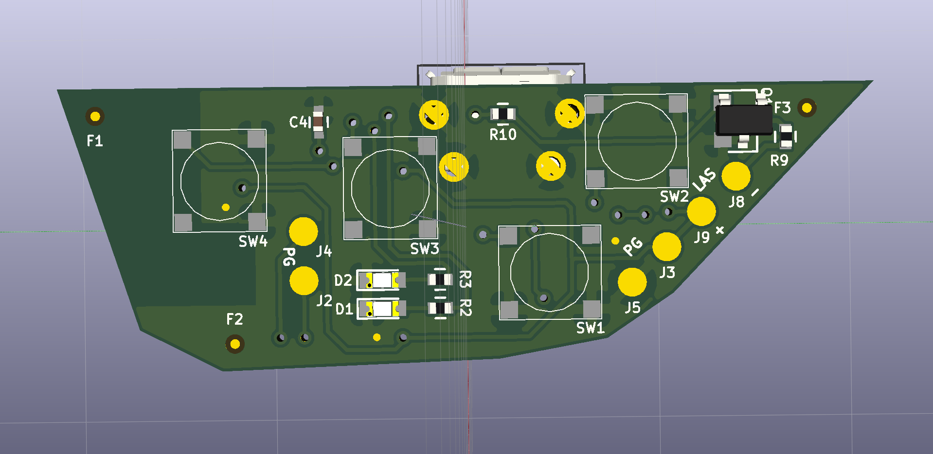

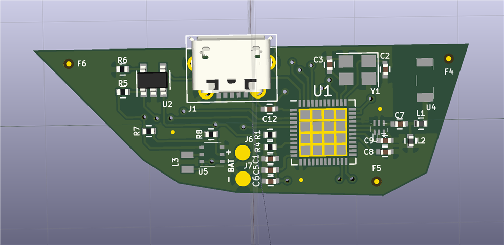

I've made a custom board with nrf51422-QFAC, which I can program with nrf51-DK. I'm using SDK 12.3.0 and SD130, which is flashed to the custom board.
When I program the custom board with some of the standard examples OR my modification of the ble_app_hids_keyboard example, it starts advertising, but:
  • On my laptop (Win10 Creators Update) I can see the device, but can't connect ("Try to connect your device again")
  • On my android phone can't find the device even from Nordic Connect App.
I'm using the internal RC oscillator:
// Low frequency clock source to be used by the SoftDevice
#define NRF_CLOCK_LFCLKSRC      {.source        = NRF_CLOCK_LF_SRC_RC,            \
                                 .rc_ctiv       = 32,                                \
                                 .rc_temp_ctiv  = 2,                                \
                                 .xtal_accuracy = NRF_CLOCK_LF_XTAL_ACCURACY_20_PPM}
An interesting point is that I've configured the advertising timeout period to be 30 seconds, but my custom board goes off on 26-27th second.
The app works fine with the nrf51-DK. I attach the schematics of my board.
Edit: One thing I forgot to mention is that I'm powering the board from nrf51-DK for now and the TPS and MCP are not used.
