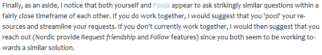

    Finally, as an aside, I notice that both yourself and Pooja appear to ask strikingly similar questions within a fairly close timeframe of each other. If you do work together, I would suggest that you 'pool' your resources and streamline your requests. If you don't currently work together, I would then suggest that you reach out (Nordic provide Request friendship and Follow features) since you both seem to be working towards a similar solution.
