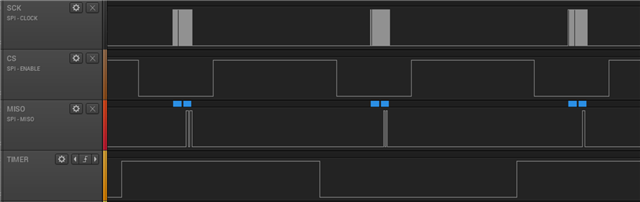

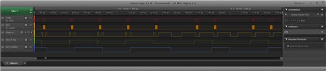

I modified the SPI master example to read an 16-bit ADC at 44.1 kHz.

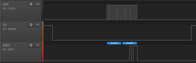

While the HAL_TIMER achieves its ~22 microseconds quite good, the SPI driver is quite slow: the CS pin stays low for 7.5 us for a 8 MHz transfer of ca 2 us (see picture). Do I have a possibility to optimize that?

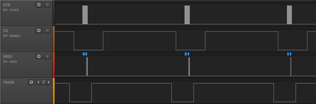

And I don't know if it's related: when I reduce the timer to 20 us, just after starting up it works fine (the toggles on the 'TIMER' channel have ca 19.9 us):
But after 28 ms it changes and I get the following shapes, as if the time did get some delay and has to catch up (total time of an ON-OFF toggle is 38.8 us):
Is the 20 us value a limit for this application?
Sébastien
  • So there are two questions here?
    1. Why is the CSN chip low for so long? This is probably, at least partly, due to the SPI driver in the SDK. The CSN pin is not automatically controlled by HW, but is controlled by SW in the driver. It seems a bit weird that it would stay low that long though.
    2. You have configured the timer to generate a waveform with a period of 20us, but then it suddenly changes to 38us? Is that correct?
    Is this nRF52832?
    Are you using a Softdevice?
    What timer are you using?
    Can you upload your code so I can test it?

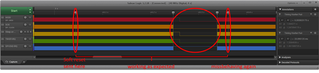

  • Hi, I just thought I'd let you know I'm still working on this. It's a very weird issue, and I need to involve some experts.

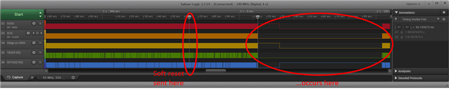

  • Here are a few more findings btw:
    One more peculiar thing that I have noticed: On a power-on-reset or pin-reset the issue occurs immediately after system startup.
    It is only right after programming the chip that it seems to work fine for ~50ms and then it starts misbehaving. Furthermore, if I use nrfjprog and perform a soft reset it seems to work as intended for about 0.5 seconds after I send the reset command. Then, after the reset, it immediately starts misbehaving again.
    Maybe you can confirm whether you experience the same behaviour?

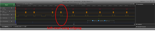

  • Hi Martin,
    Finally managed to test your setup. Result: I can reproduce your results with two exception:
    1. instead of 0.5s between soft reset sending and occurence, I have changing times (measured between 50 and 300 ms).
    2. After the softreset occurence, I (sometimes? always?) get a correct behaviour for some ms

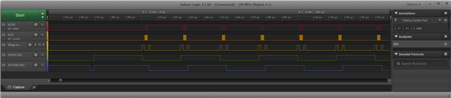

    Startup after download (note: since I have a slow logic analyzer, I had to toggle the IRQs):

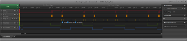

    Behaviour change after ~30 ms:
    Startup after power cycle:
    nrfjprog reset:
    softreset before/after:
    Best,
    Sébastien

    I have done some more testing and removed all the SPI related code. The issue with the prolonged CPU awake time is still there. After about 40 ms (+- 10ms) the CPU awake time is suddenly 10 times longer than before. It goes from 1.242 us to 12.43 us.
    Furthermore, there seems to be a difference in behavior dependent on how the application starts:
    • Soft reset: This works as explained above. Everything seems normal for ~40 ms (+- 10 ms), then the CPU awake time is suddenly 10 times longer.
    • Pin reset or Power on Reset: The CPU awake time is longer from the very beginning of the application.
    I'm still not sure what the problem is. Fair enough, there is an inevitable latency between an interrupt is being triggered and until the code in the ISR is being executed, but it should only be 10 or 12 clock cycles on the Cortex M4 if I remember correctly. Not close 10 microseconds as we see in the logic trace. And it is strange that the latency seems to change after some milliseconds. It could be that the debugger is playing tricks on us. I'll keep asking around.
    Unfortunately I'm going out of office again, but I'll see if someone can look into it while I'm gone.
