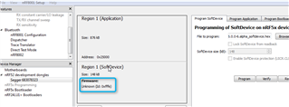

BTW, I can't get the S140(s140_nrf52840_6.0.0-6.alpha) ID using the command "nrfutil pkg generate --help",
because the S140 ID info lack. Therefore,using nrfgo, I program the SoftDevice hex, and see the ID info:
the S140 ID is 0xfffe, right? why the dialog shows "Firmware: Unknown" ?
The latest version of nRFGo Studio was released in 2015, and the SD140 didn't exist at the time, that's why. Don't worry about it.
You will find more informations about FWIDs in this thread.

relate to S140(s140_nrf52840_6.0.0-6.alpha).
the firmware id above(0xfffe) is not right one?
normally, the firmware id is only one byte.like:

It's on 2 bytes, see the link in my previous answer.
0xFFFE is for "Development/Any". We would need Nordic advice here, but it's probably because that is an alpha release?
Yes, all Softdevices that are an alpha release will have that ID.
