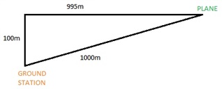

I would like to use the nRF52840 modules for moving nodes. However, I'm concerned that the modules will not be able to cope with high moving velocities to communicate or pair among them. If there is a speed limit to work with moving devices, I would be glad to know, thank you.
I'm also wondering about the relation between the transmission power and the range, since there is no information about the range of this module in both urban and outdoor (line of sight) areas.

    In the following calculations I will assume that the plane flies over the ground station in a straight path and that the environmental conditions are ideal.
    We have tested nRF52840 in Bluetooth 5 Long Range Mode and +8dBm output power at distances over 1km. For simplicity I'll use 1000m as the value for maximum distance between plane and ground station where they can communicate. In this video we test at 750m+, but it can go much further.
    Doing some hand calculations (using an online trigonometry calculator) we can see that we have a 995m distance where we can maintain a connection. Let's round it up to 1000m and double it since we have the same distance as the plane is flying away from the base station.
    Since the plane is moving at 50km/h ≈ 14m/s we have a total of (2000m) / (14m/s) ≈ 140 seconds available to transfer the data.
    The theoretical data rate of BT5 Long Range is 125kbps. In practice we are closer to a throughput of 25kbps application data.
    In 140 seconds we can transfer 25kb * 140 = 3500kb = 437kB of data. This is 8 times more than the specified 50kB requirement.
    In conclusion, you should be able to solve your use case with two nRF52840 devices.
