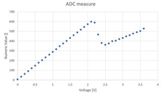

Hi there,
I'm testing the "saadc" example : <InstallFolder>\examples\peripheral\saadc
I haven't changed the code.
To do this, I use the nRF52840 with SDK 14.2 and s140 softdevice.
The nRF52840 is powered by a USB cable.
To observe the values, I use a terminal emulator (PuTTY). Then, I use an external power supply on AIN0 that I vary between 0 and 3.6V to observe the numerical value on the console.
Everything is going well, until my measured voltage exceeds 2.1V. You can see this in the next capture:
I would like the curve to remain linear up to 3.6V. Do you have an idea for solving my problem?
