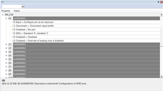

  • The GPIOTE module is powered down in system OFF mode, but pin configurations are retained. To narrow down the problem I suggest to go through the pin configurations to make sure that only wake up pin is configured with sense enabled. One way of doing this is to place a breakpoint at the line where sd_power_system_off(); is called, then read out the NRF_GPIO->PIN_CNF[n] registers.
    Peripheral viewer in Keil (From menu tab: View ->System Viewer -> P0)
  • I have checked the NRF_GPIO->PIN_CNF[n] registers  - all are either configured as inputs (0x00000002) or outputs (0x00000003), apart from pin 13 (REED_SWITCH_PIN) which is 0x00030000 as expected.

  • I have solved the issue of PIN 20 being latched incorrectly by making PIN 20 use a GPIOTE IN event all the time, and REED_SWITCH_PIN (13) using the PORT event all the time.
    Now with a breakpoint on sd_power_system_off, everything looks normal - all PIN_CNF values are 0x00000002 or 0x00000003 with the exception of the REED_SWITCH_PIN which is 0x00030000.
    Latch registers when sleeping with the REED_SWITCH_PIN pulled high (by the external pullup) are all clear.
    Latch registers when sleeping with the REED_SWITCH_PIN pulled steady state low indicate PIN13 is latched (as expected I think?).
    The behaviour in the main question remains unfortunately.
