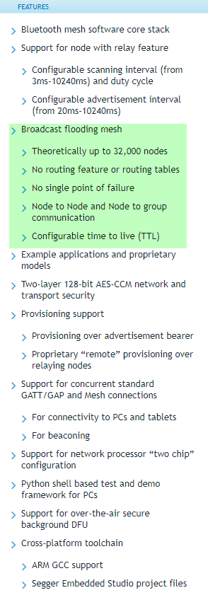

Does nRF52 DK support managed flood?
hello kalmi123,
Yes, the current Bluetooth SIG Mesh specification v1.0 implements a managed flood approach to ensure network message delivery. Additionally, the current Nordic Mesh SDK (which supports the nrf52832, nrf52840 and nrf51) is fully compliant with the Bluetooth SIG Mesh standard and therefore it also implements a managed flooding approach.
The following graphic (with pertinent section highlighted) is taken from the Nordic nRF5 SDK for Mesh anchor page on the Nordic website...
