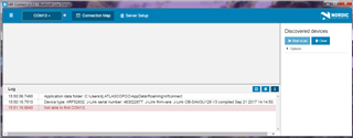

I try to run UART/Serial Port Emulation over BLE on SDK v14.2.0 with nRF52 DK and nRF Connect on Android phone following link "http://infocenter.nordicsemi.com/index.jsp?topic=%2Fcom.nordic.infocenter.sdk5.v12.2.0%2Fble_sdk_app_nus_c.html&cp=4_0_1_4_2_0_2". I compile and download example code with softdevice S132, the phone detect Nordic-Uart, and connected, but nothing more than that, if I try to send something, BLE will disconnected, even it will be re-connected if requested. I run Tera Term on PC, it shows Nordic-UART, but does not show anymore thing, no response to keyboard. There are some code displayed in this link, they are said added to be added in softdevice, it is not clear that they are already added and I do not have to add them in again, if that is the case, why they are displayed here. If not added, where they should be added, in main.c or ble_nus.c? Please help!

  • Hi, Jorgen: Great! Both nRF Connect v1.1.1 and V2.3.0 works with nRF52DK, I try to find out why Murata DVK module does not work, it has the same host MCU and nRF52832 SoC. I noticed that both versions like to re-program DK with the latest connectivity firmware, are they programming different connectivity firmware? How important is the latest connectivity firmware, it seems mobile version nRF Tool box does not requires the latest firmware, is this firmware mainly required on serial communication that nRF52832 talk to the host MCU, not BLE radio communication? If yes, do I need the latest firmware code in my host processor to control Murata module apart from your SDK code to control BLE radio, if yes, where can I find the source code? Murata does not know why its module cannot be reprogrammed and they has no tool to program its module, their support is really poor.
