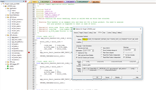

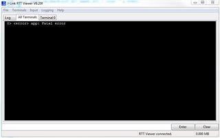

I can compile the code but when I upload the code device can not advertise and RTT Viewer output get  fail.
 "0> <error> app: Fatal error"
Do you have any suggestion ?
