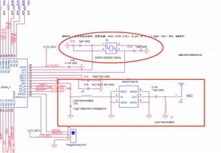

i have question about nRF52832's bluetuth. xtal is 32M, Cload  is 12pf, but the frequency is 2.402199G(tested by Network Analyzer),  Frequency differency is 199K.  We find that bluetuth may disconect;  Disconnect is individual problem, not common problem. Pout is 1.9dbm, We can't fix it.  what should i do next?
schamtic:
layout:
