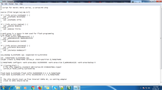

i uploaded two pics one for nrf51.config file used with opencd.....

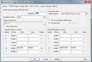

one for DFU rom address..

    The linker settings shown in you screen-dump is incorrect, the first section of flash is actually reserved for the softdevice (memory layout). Recommend that you get a clean copy of the SDK, and use the default bootloader example as reference.
  • i didn't change anything i used dfu bootloader example as it is and sent you screenshot of it's rom location..so tell me what ROM configuration i should do.and for what i mean bootloader, softdevice and application.and make change in softdevice because i have only hex file for it.
    when i upload flash using opencd like following
    flash write_image softdevice.hex 0
    than loaded ....than after i load application
    flash write_image application.hex 0
    also loaded than i give
    reset run
    after this command device running and advertising service...it's works fine

  • The initial stack pointer for your bootloader is set to 0x20001418, which is in the softdevice's reserved memory. It's expected to be closer to 0x20003C00 with the default linker settings that I provided earlier.

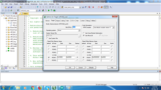

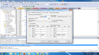

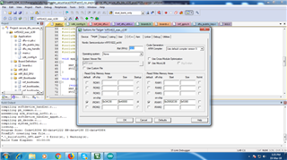

    i already changedand compiled DFU settings as you gave earlier. i attached pic you can see it.and also sent you application settings
  • I see the device type has been changed from xxAC (default) to xxAA, which will reset the project configuration. The linker settings appear to be correct, but the .hex file you sent does not correspond with the configuration shown in the screenshot.

  • Changing the device type will reset the linker configuration to the default range for that device type. That is, use all available flash and ram. But it should have worked after you updated the settings to the correct values. For some reason, the ram allocation does not seem reflect the changes you made.
    51822_xxAC and 51422_xxAC are identical except that the latter is licensed for use with the ANT protocol stacks (s2xx and s3xx). Suggest to try again with a clean SDK copy without making any changes to the configuration (you may add your own key set). Then verify that the initial stack pointer is >0x20002C00
