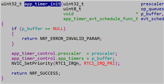

            In the Power Profiling Application (an example of nordic SDK), the priority of the application timer is set to APP_LOW(as shown in the pic below).

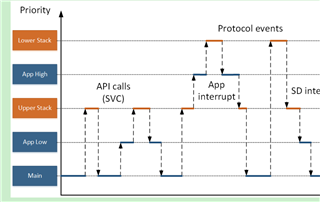

However, according to the pic below, as sd_app_evt_wait() is a SVC, how can the application timer with a lower priority wake up the SOC ?

    There is a mismatch between the softdevice specification (SDS) and the SDK examples: The SDS says that the software interrupt priority level of the softdevice is '4' (APP_IRQ_PRIORITY_MID). However, in the applications in the SDK, it is set to APP_IRQ_PRIORITY_LOWEST, see swi_interrupt_priority_workaround(..) in nrf_sdh.c.

  • Thank u for your valueable answer. If the software interrupt priority level of the softdevice is '4' (e.g. for sd_app_evt_wait() ) and the priority of the timer in this application is set to APP_LOW, how can the application timer wake up the SOC ? (The ISR of the timer is to call  sd_ble_gatts_hvx() to send data).

    sd_app_evt_wait() does only put the chip to sleep, it doesn't stay in that priority level. Therefore, a timer of priority APP_LOW can wake up the chip.
