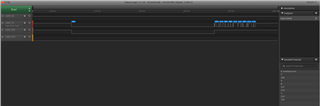

I have not got UART logging enabled. I use a logic analyzer to see what is being sent.
I noticed the Receiver does not block while waiting to receive.
Here is the source code:
The same source code is build with `-DSENDER=1` for the sender and no declaration for the receiver.
When the receiver is switched off, I can see my packet being sent from the sender.

    Error3 ret:0x3 (error_reg:0x4)
    From the doc (http://infocenter.nordicsemi.com/topic/com.nordic.infocenter.nrf52840.ps/uarte.html?cp=2_0_0_33_9_4#register.ERRORSRC), it means it is a FRAMING error (A valid stop bit is not detected on the serial data input after all bits in a character have been received.).
    I am guessing I forgot something when sending my command. But I cannot find what is missing from the sender...
  • Actually the logic analyzer see the framing error. But I cannot find the error in my code.
