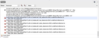

I try to add SoftDevice S140 to the spis_pca10056 project but I got multiple error ... I already fixed a lot but I don't get to fix the errors that stay ...
Here's the errors :
Anyone can help me to fix them ?
Sylvain.

Hi Sylvain,
It looks like your flash_placement.xml file is missing the sections required for a SoftDevice project.
Could you try copying in a flash_placement.xml from for instance the ble_app_hrs/pca10056/s140/ses into your project and see if it links properly?
Cheers,
Håkon
Hello Håkon,
Now it compiles ! Thanks for the tip ...
Now I'm interested to know how I can configure a flash_placement.xml file .. Do you know ?
Sylvain
Segger uses a .xml -> .ld linker script converter.
You can look at Segger's documentation on the flash_placement sections:
https://studio.segger.com/index.htm?https://studio.segger.com/ide_section_placement.htm
Håkon
