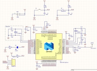

  • My schematics
    Here is board schematics overhead.

    There are no serious difference between nrf51822 and nrf52832 mcu code. But when i  use nrf51 current consuption is 1.5 - 2 ua against 10 uA with nrf52.
    Also i noticed that in a low power mode ( __WFE(); instruction) HF generator stay active and sourced by RC gain. I thought it will inactive when LF (32768 crystal) using in LPM.
    I cant use power off, becouse i need gpio (gerkon) interrupt on LOW and HIGH level both (switching between low and high).
    I measure current consumption with my measuring tool with 0.1 uA resolution in LPM mode only. In RX & TX  modes it  consumes 14 - 20 mA as it is in datasheet.
