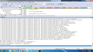

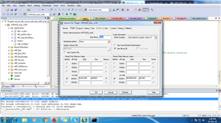

    My probleme after uploading DFU ,SOFTDEVICE AND APPLICATION .device always in DFU mode and also when try to upload new application via DFU it's failed to upload.

    If you were talking about downloading the hex files with a programmer then the explanation is the following: The bootloader uses a "bootloader settings page" to store information about the appliation. This settings flash page is updated when you do DFU, but if you program the hex files directly then the settings page is not written. You can generate the settings file using nrfutil. See for instance this answer to a previous thread about the same.
    If you were talking about the result after doing a BLE DFU, please let me know.
    The zip file looks fine.
    Do you still see the other issue, with the "no space"?
