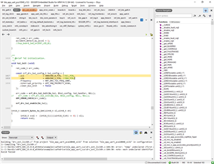

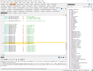

Dear sir,
I have merged the twi_sensor code in ble_app_uart code in order to read the temperature sensor MAX30205 with NRF52832 send it over Bluetooth. But I am getting temperature  value as zero form the sensor in buffer. Here is my code. Please tell me where I am going wrong.

void twi_init (void)
ret_code_t err_code;
const nrf_drv_twi_config_t twi_lm75b_config = {
.scl = ARDUINO_SCL_PIN,
.sda = ARDUINO_SDA_PIN,
.frequency = NRF_TWI_FREQ_100K,
.interrupt_priority = APP_IRQ_PRIORITY_HIGH,
.clear_bus_init = false
err_code = nrf_drv_twi_init(&m_twi, &twi_lm75b_config, twi_handler, NULL);
nrf_drv_twi_enable(&m_twi);

  • Hi Manoj,
    I'm also faceing similar problem. Even i'm not getting any SCL and SDA signals from the slave(LIS3DH) accelerometer.
    But, when i'm trying just simple transmission program(nrf_drv_twi_tx) i got SCL and SDA signals.
    My program is similar with your program. My doubt also twi_handler proper working or not.
    Are you fix the issue and if fixed can you descripe please.
    I'm using nrf52832(SoC) and LIS3DH accelerometer with bluetooth app functions.

  • I'm also faceing similar problem
    So have you followed the same diagnostic steps?
    Have you tried the TWI scanner?
    Have you verified the I2C Slave Address?
    You will never get SCL from any I2C Slave - by definition, the clock is only and always generated by the Master.
    And, of course, the slave will not respond if you have the Slave Address wrong.
    So what is the difference between that situation, and the situation with your LIS3DH accelerometer?
    Are your hardware connections correct?
    Do you have proper pullups?
    Post schematics.
    Start by working on the I2C alone - you don't need the added complications of BLE!
