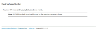

What is the RTC run current on the nRF528120? It is not listed in the datasheet.
In addition, what is the run currents for the clocks on the 810? There is no information regarding the current draw on the clocks.

The final characterization data is not available yet, but you can assume they will be very similar to those of nRF52832 with regards to the clocks and RTC. I believe the major improvements in current consumption will be EasyDMA related.
