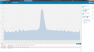

    If you have an extra nRF52 DK kit you can use nRF Connect for desktop and the RSSI Viewer plugin to visualize the spectrum. After modifying your code my RSSI Viewer showed me this:
