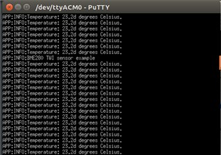

I am trying to make BME280 sensor work with nRF51 DK. I just need temperature readings. So i searched if there was some examples using this sensor and i found this example.
https://github.com/knuta/nrf5-bme280-twi
I have tried the example and i get only one fixed temperature value on UART. Here is screenshot.
The buffers with measured data are also not changing when i debug.
I have checked the registers that are used for configuring the sensor and registers for reading, they seem to be ok.
What could be the issue, could you give me some pointers?
