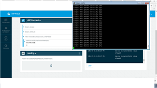

I have set up an environment to upload data to the nrfcloud using nrfconnect and the nrf52 dk.I can only upload data upto ff and then it resets to zero .The value which i am uploading is an integer value, so i want to display numbers from 0 to atleast 32000 on the cloud.Here is an image of the cloud so far.I have used the code in this page to upload data using notification to the cloud.How must i increase the number of bits which is 00 to 0000 on the service where maximum value will be 65585.Do i have to do changes in the code?please help
here is the notification handler code.
