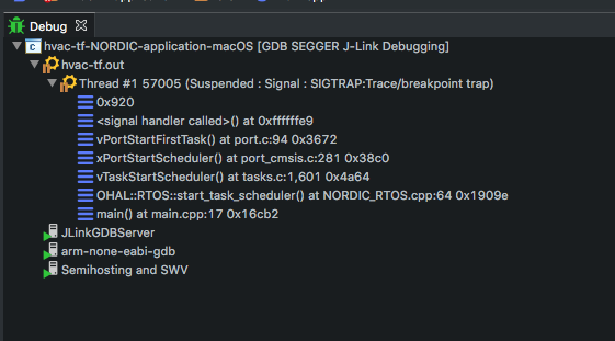

Call to vPortStartFirstTask() fails in FreeRTOS when the MBR used without the Soft device
Hi All,
I am developing an application on nRF52840 Preview DK which does not need the Soft device. But it needs the MBR to run a bootloader for Firmware update purpose.
I've taken the MBR from Thread SDK as suggested in:
https://devzone.nordicsemi.com/f/nordic-q-a/31133/how-to-separate-the-mbr-from-the-softdevice
The size of the MBR is 0x1000. Therefore, I am setting the origin of the linker script at 0x1000.
The linker script I am using to build the application is as follows:

To develop the application I am using FreeRTOS.
I have noticed that if I set the origin of the application to 0x0, it works as expected. But if I set it to 0x1000 (as seen in the above linker script), the application halts.
As can be seen in above image , the call to vPortStartFirstTask() fails.
This does not happen when softdevice is installed or the origin is set to 0x0.
Could anyone suggest what is going wrong here?
