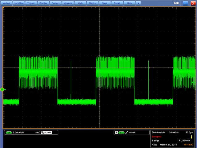

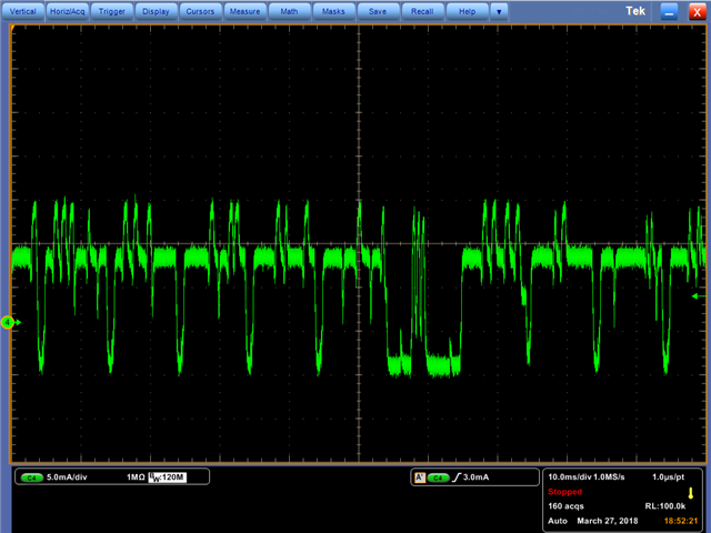

I test SoftDevice V6.0.0 on nrf52832(BLENANO2)
I run
1. sd_ble_gap_scan_start() 1000ms/100ms/10ms scan_window/scan_interval
2. sd_ble_gap_adv_start() 1000ms interval
result. (see picture)
for example,
scan interval is 1000ms, scan-off -> advertise -> scan-on duration is about 1000ms.
scan interval is 10ms, scan-off -> advertise -> scan-on duration is about 10ms.
Why?
