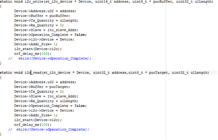

       we are using SDK v8.1.0, didn't use APP_TWI_INIT function to initialize the i2c, we have written the drivers for i2c initialization.
    We have set CSTACK size to 3k and Heap Size to 0, As per S110 SDS_v2 Document CSTACK has to start from address  0x20003fff to 0x20003402, but in our Application Cstack address starts from 0x20002e96 to 0x20002298.
    Our Application RAM usage:
     Application RAM address starts from  0x20002000 to 0x20002295, followed by CSTACK address  0x20002e96 to 0x20002298, followed by Application RAM address starts from 0x20002e98 to 0x20003c5f, but it has to be readwrite,Heap,CSTACk in this order as per S110 SDS_v2 . why it is so?
    After Application hangs, when we check call stack contains [NRF_POWER_RAMONx_RAMxON_ONMODE_Msk + 0x6ad] in debug mode, what this indicate?
     * \file i2c.c
     * \brief nRF51822 I2C driver file
     * \author	Sowmya B R
     * \date 2015-09-29
     * \version	0.1
     *  --------------------- INCLUDE FILES ---------------------
    #include <stdint.h>
    #include <stdbool.h>
    #include <nrf51.h>
    #include <nrf_delay.h>
    #include <nrf_drv_common.h>
    #include <app_util_platform.h>
    #include "drivers/i2c.h"
     *  --------------------- DEFINITION ---------------------
     *  --------------------- Global variables ---------------------
    static uint32_t Addr_Size;
     *  --------------------- FUNCTION DECLARATION ---------------------
     *  --------------------- FUNCTION BODY ---------------------
    void i2c_init(st_i2c_config * StI2C)
    	NRF_GPIO->PIN_CNF[StI2C->Clock_Pin] = ((GPIO_PIN_CNF_SENSE_Disabled << GPIO_PIN_CNF_SENSE_Pos)
                                | (GPIO_PIN_CNF_DRIVE_S0D1     << GPIO_PIN_CNF_DRIVE_Pos)
                                | (GPIO_PIN_CNF_PULL_Pullup    << GPIO_PIN_CNF_PULL_Pos)
                                | (GPIO_PIN_CNF_INPUT_Connect  << GPIO_PIN_CNF_INPUT_Pos)
                                | (GPIO_PIN_CNF_DIR_Input      << GPIO_PIN_CNF_DIR_Pos));
    	NRF_GPIO->PIN_CNF[StI2C->Data_Pin] = ((GPIO_PIN_CNF_SENSE_Disabled << GPIO_PIN_CNF_SENSE_Pos)
    	// set frequency
    	StI2C->nRF_I2C->FREQUENCY = StI2C->Frequency << TWI_FREQUENCY_FREQUENCY_Pos;
    	// configure i2c clock and data lines
    	StI2C->nRF_I2C->PSELSCL = StI2C->Clock_Pin;
    	StI2C->nRF_I2C->PSELSDA = StI2C->Data_Pin;
    	StI2C->nRF_I2C->INTENSET = TWI_INTENSET_TXDSENT_Msk | TWI_INTENSET_STOPPED_Msk | TWI_INTENSET_RXDREADY_Msk;
    	StI2C->nRF_I2C->ENABLE = TWI_ENABLE_ENABLE_Enabled << TWI_ENABLE_ENABLE_Pos;
    void i2c_start(st_i2c_config * stI2C)
    	stI2C->nRF_I2C->ADDRESS = stI2C->Device->Slave;			// transmit slave id
    	Addr_Size = stI2C->Device->Addr_Size;
    	if(Addr_Size > 0)
    		Addr_Size--;
    		stI2C->nRF_I2C->TXD = stI2C->Device->Address.u8[Addr_Size];
    		// transmit the address
                 // stI2C->nRF_I2C->EVENTS_RXDREADY = 0;
                    stI2C->nRF_I2C->TASKS_STARTTX = 1;
    	else
              stI2C->nRF_I2C->TASKS_STARTRX = 1;
             // stI2C->nRF_I2C->TASKS_STOP = 1;
    		//return;
    	//stI2C->nRF_I2C->TASKS_STARTTX = 1;
    void i2c_irq_handler(st_i2c_config* stI2C)
    	if(stI2C->nRF_I2C->EVENTS_TXDSENT != 0)
    		stI2C->nRF_I2C->EVENTS_TXDSENT = 0;
    		if(Addr_Size > 0)				// Is Address is there?
    			Addr_Size--;
    		else if(stI2C->Device->Tx_Quantity)
    			stI2C->nRF_I2C->TXD = *stI2C->Device->Buffer++;
    			stI2C->Device->Tx_Quantity--;
    		else
    			if(stI2C->Device->Rx_Quantity == 0)
    				stI2C->nRF_I2C->TASKS_STOP = 1;			// write complete
                            else
                               stI2C->nRF_I2C->TASKS_STARTRX = 1;			// repeated start
    	if(stI2C->nRF_I2C->EVENTS_STOPPED)
    		stI2C->nRF_I2C->EVENTS_STOPPED = 0;
    		stI2C->Device->Operation_Complete = true;
    	if(stI2C->nRF_I2C->EVENTS_RXDREADY != 0)
    		*stI2C->Device->Buffer++ = stI2C->nRF_I2C->RXD;
    		if(--stI2C->Device->Rx_Quantity > 0)
                      stI2C->nRF_I2C->TASKS_RESUME = 1;
                    else
    		  stI2C->nRF_I2C->TASKS_STOP = 1;		// read complete
            // Handle errors.
            //if (stI2C->nRF_I2C->EVENTS_ERROR != 0)
    		//stI2C->nRF_I2C->EVENTS_ERROR = 0;		// Clear UART ERROR event flag.
    		// Clear error source.
     *  --------------------- End Of File ---------------------
     * \file i2c_0.c
     * \brief
     * \date 2015-09-30
     * \version	0.1
    #include <nrf51.h>
    #include "drivers/i2c_0.h"
    #include "drivers/gpio.h"
    st_i2c_config I2C_0 =
    	.Clock_Pin   = TWI_MASTER_CLOCK_PIN,
    	.Data_Pin    = TWI_MASTER_DATA_PIN,
    	.Frequency   = TWI_FREQUENCY_FREQUENCY_K100,
            .nRF_I2C     = NRF_TWI0,
    	//.PPI_Channel = PPI_CHANNEL,
    void SPI0_TWI0_IRQHandler(void)
    	i2c_irq_handler(&I2C_0);
    void init_i2c_0()
    	//I2C_0.Frequency = Frequency;
    	i2c_init(&I2C_0);
    	//NVIC_SetPriority(SPI0_TWI0_IRQn, APP_IRQ_PRIORITY_LOW);
    	//NVIC_ClearPendingIRQ(SPI0_TWI0_IRQn);
    	//NVIC_EnableIRQ(SPI0_TWI0_IRQn);
           sd_nvic_SetPriority(SPI0_TWI0_IRQn,APP_IRQ_PRIORITY_HIGH);
           sd_nvic_ClearPendingIRQ(SPI0_TWI0_IRQn);
           sd_nvic_EnableIRQ(SPI0_TWI0_IRQn);
