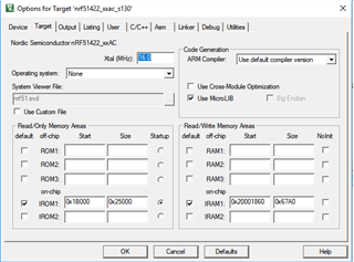

Which are the proper Settings to Debug a J-Link NRF51822 project with Keil?
I'm having some trouble trying to download a program to Flash memory from Keil, the console doesn't give any errors but the program doesn't really load into the MCU (NRFGo shows only one Application region, no Softdevice at all). The only way I can download the program is by using the .hex generated by Keil and load it with NRFGo after loading Softdevice S130, however I would like to debug using the J-Link. Am I missing something in the "Options for Target" menu?
