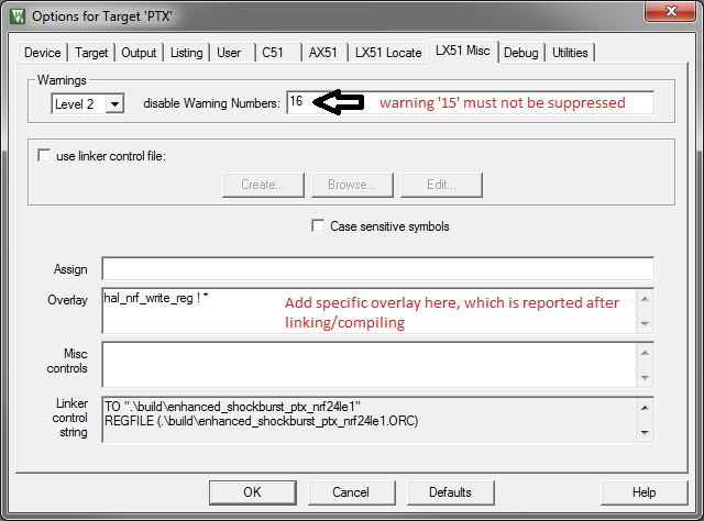

Hi, Can the RF irq be triggered while it's already executing? I'm having a strange problem that may be explained by this. Best, Mahesh

    Since the 8051 has limited memory, the stack is not re-entrant.
    It may be that you have issues wrt. memory overlay.
    This means that if you enter function_1(), the auto-variables in this scope will always have the same address area.
    This is a problem when you introduce interrupts. If function_1() is called from main and interrupt context, you may get into a scenario where you are in the same scope in main and the interrupt, thus corrupting (read: overwriting) your scope variable.
    To fix this, you have to set "Memory overlay" specific linker options to tell the linker not to place the segments in the same area. I am attaching a picture that shows where to set this.
    When warning #15 is not suppressed, the linker will give you warnings about segments that are called from interrupt and main thread. You then add this to the linker Overlay section:
    function_1 ! *,
    function_2 ! *,
    function_3 ! *
