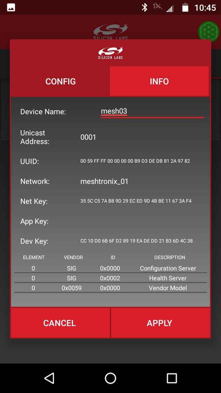

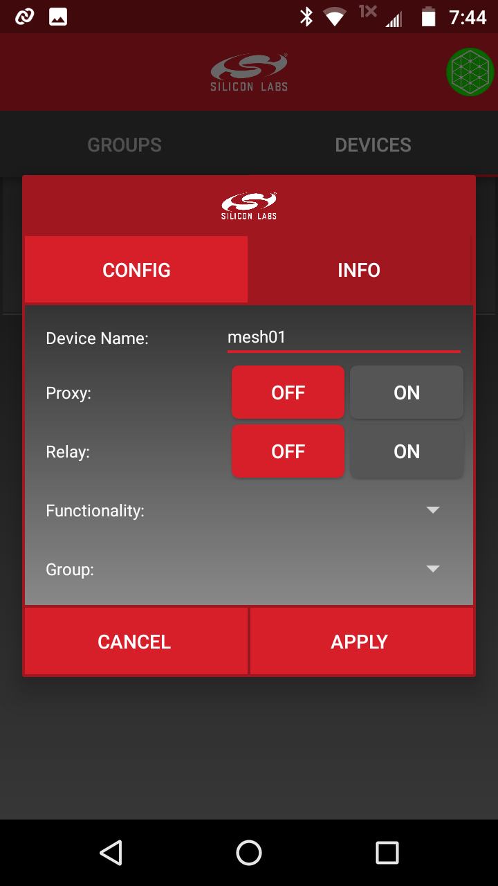

    We did some limited work on this about a month ago or so when the Nordic Mesh SDK v2.x was delivered. From re-collection we managed to see the nRF5 Mesh light switch nodes within the Silabs app but there appeared to be an issue with the composition data that was being sent from the Nordic end (haven't had time to write it up as a question in devzone as yet)...
    In any case, I believe we had to do the following:
    1- Amended the light switch code to use the Network Key that Silabs issued when it created its network (by default the Nordic provisioner generates random keys)
    2- Amended the light switch code to use numeric pin based OOB authentication (it uses static OOB auth by default)
    Again, we got a few devices provisioned over PB-GATT but the configuration process failed. I've included some screenshots which we took at the time which shows some of our progress.
    (a) unprov'd nrf5x Mesh Light Switch device (as seen in nRF Connect app) note the 0x1827 Mesh beacon type as well as the UUID
    (b) nrf5x Mesh Light Switch node after being provisioned into the Silabs app (note the 0x0059 Nordic vendor ID as well as the UUID
    (c) nrf5x Mesh Light Switch node after being provisioned but ability to set Proxy/Relay not functional
    (d) a 3rd nrf5x Mesh Light Switch node provisioned into network
    If I get some time, i'll try to take things further on this end and let you know whether we manage to toggle lights etc. from Silabs (note: we've achieved toggling with nrf52's using Zephyr firmware but that uses the generic on/off SIG model and not the custom model used in the Nordic light switch demo)
