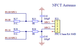

Please tell me how to configure the NFC pine P0.09 & P0.10 as GPIOs. I followed all the procedure given in the development kli manual & on the nordic blogs also(i.e in Project Settings ).But still not succeeded.

Hi, GPIO P0.09 and P0.10 are connected to the NFC header on the development kit. If you want to use the GPIO header instead you need to move the resistors R25 and R26 to R27 and R28. The resistors are actually just 0 Ohm so you could just solder the R27 pads together and the R28 pads together. Please see the DK schematics for more info.
