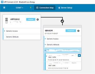

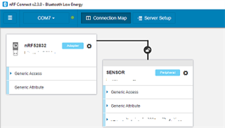

As soon as I connected via "nRF Connect", function "sd_ble_gatts_hvx" returns: NRF_ERROR_SVC_HANDLER_MISSING.
The window looks like:
If I open the window:
functions "sd_ble_gatts_hvx" returns NRF_ERROR_INVALID_STATE, which without enabled notification is correct value. Does anyone know, what happen in app when I open this window?
Why functions returns NRF_ERROR_SVC_HANDLER_MISSING ?

    The application wants to send data using ble_first_service_send() no matter the connection state. After the device is connected, the central has to enable notifications before the peripheral can send notifications (sd_ble_gatts_hvx). If not, the error NRF_ERROR_SVC_HANDLER_MISSING is returned.
    When using the central to enable notifications, the error disappears.
