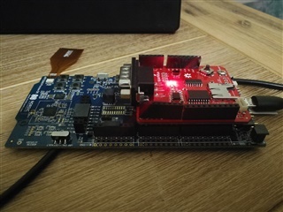

I am trying connect nRF52480 Preview DK and an Arduino UNO CAN Bus shield.
What I did is:
1) I directly hook CAN Bus shield on the top of nRF52480 Preview DK.
2) configure SPI PIN number corresponding to Arduino SPI PIN number.

3) modify a CAN bus library...
I would like to know if 1) and 2) are correct?
Appreciate for any comments!
