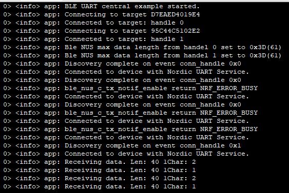

I am using 3 nrf52 DKs with S132 and SDK14 / and SDK15 to try and implement a combination of the multilink and UART examples. I started with the ble_app_uart_c example and added the relevant code from the ble_app_multilink_central example to connect to multiple (in my case 2) peripherals.
If I call in the ble_evt_handler() in case BLE_GAP_EVT_CONNECTED the function scan_start(); then the ble_nus_c_evt_handler() with the case BLE_NUS_C_EVT_DISCOVERY_COMPLETE is called three times. If I don't call the scan_start() function in the BLE_GAP_EVT_CONNECTED case the BLE_NUS_C_EVT_DISCOVERY_COMPLETE  is called only ones.
But in both cases the central is not connecting to the second peripheral. As soon as I switch of the connected peripheral, the other peripheral is connecting and exchanging datas.
What do I miss that I can connect to the two peripherals at the same time?

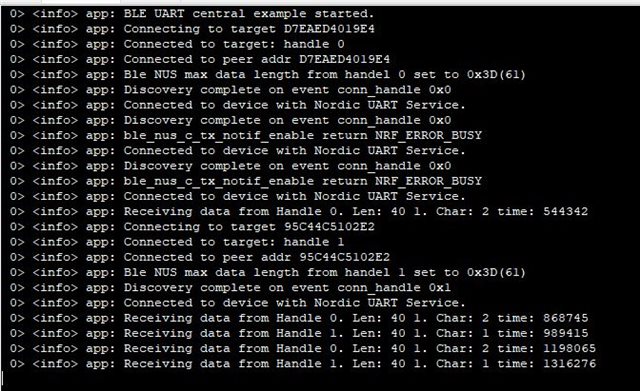

  • Hi, thanks for the information:
    in the sdk_config.h file I changed only the NRF_SDH_BLE_TOTAL_LINK_COUNT,  but the NRF_SDH_BLE_CENTRAL_LINK_COUNT remaind on the default value. After changing this definition I can connect the several peripherals.
    But the "problem" that connection 0 is calling the le_nus_c_evt_handler() with event BLE_NUS_C_EVT_DISCOVERY_COMPLETE remains. see the screenshot from the NRF_LOG INFOS.

  • I think the problem here is that BLE_NUS_C_EVT_DISCOVERY_COMPLETE is not cleared after reported to the application, thereby it is reported multiple times while doing a service discovery on the second connection. I will report this internally as a bug, I assume the fix will be in ble_nus_c_on_db_disc_evt(), where after calling p_ble_nus_c->evt_handler(p_ble_nus_c, &nus_c_evt); you need to for instance set nus_c_evt.evt_type    = NULL; or similar.
