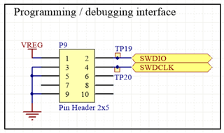

Hey Team,
Can anyone please share the layout of the Program and Debug connector on the Thingy? I don't have a 10 pin SWD connector readily available and need to start communicating with the device ASAP.

Here you go:
The pinout is standard for ARM SWD connectors.
