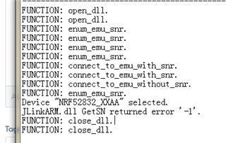

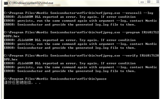

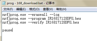

It show like the picture in the log.log file
but I can download the firmware by the J-FLASH
THE chip is Nordic Semi nRF52832_xxAA
the jlink version is V6.30J
nrfjprog verion 9.7.2
What kind of programmer are you using?
Hi thanks for your reply
It‘’s ok now,It is because of the chinese copy jlink
