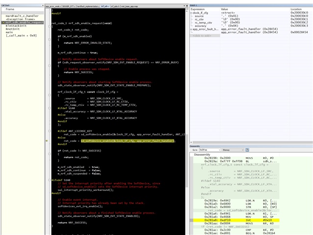

Ending up in error handler with sdh_stack_observer on the call stack
It seems like I should be able to find this in docs somewhere but having trouble finding the information.
What exactly is the sdh_stack_observer and if I'm ending up in an error handler with sdh_stack_observer shown on the debugger call stack and not much else, what should I be looking for or what is this an indication of?

    Could you provide some more information about how the call stack looks like ?
    Maybe you could upload a screenshot?
    I recommend adding the preprocessor define "DEBUG" to your project in order to enable blocking assertions. It's also important that you set the optimization level to 0 when debugging to get the proper call graph.
  • Thanks - I've made sure DEBUG info is turned on. I'm getting a hard fault when calling nrf_sdh_enable_request. I don't see any issues with the arguments.  Could it be related to the low frequency clock already enabled before the soft device is getting enabled?  I do have another project that enables fine. I have not been able to figure out what the difference is.
    <error> hardfault: HARD FAULT at 0x000281AA
    <error> hardfault: R0: 0x200030C0 R1: 0x00028455 R2: 0x00000000 R3: 0x000313CB
    <error> hardfault: R12: 0x00000009 LR: 0x000280E3 PSR: 0x6100000B

  • So I think (fingers crossed) this problem has gone away. I think this might have been an IAR debugger setting. We didn't have the "-drv_vector_table_base=0x0" in Debugger->Extra Options.  Apparently deselecting "Use flash loaders" and adding this works around some known issue debugging with IAR?
  • That is correct. The --drv_vector_table_base=0x0 should be present in all IAR examples in the SDK.
