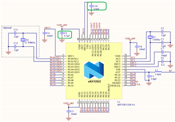

1,3V regulator supply decoupling capacitor missing ! (nRF52832 )
i was about to solder my PCB that contain an nRF52832 and i've noticed that i didn't have C9, C10 capacitors.
 C10 is the 1uF decoupling capacitor for the 1.3V regulator supply (DEC4) and C9 is the 4.7uF capacitor connected to the VDD.
so i'm wondering if i solder the PCB without these components the nRF will work ?
and can i replace the C10 with 100nF capacitor available ?
