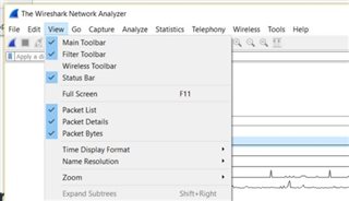

1) In wireshark I see no  'Interface Toolbars' selection under the 'View'  folder.
