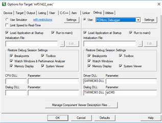

I am trying to flash a nrf51 dk with keil5. When I try to flash it with a multilink universal I get this error:
My settings are the following:
Thank you.

Hi, if you are using the nRF51 DK use the on-board JLink programmer. The examples are configured to use this by default. You might have to click on settings and select the correct JLink serial.
I have no problem using the on-board JLink, but on my final project I will have only the NRF51422, so I would like to program it via peµ
How are you powering the DK? If you power the DK over the USB port and connect the programmer to the "debug in" port the on-board programmer will probably hold the SWD lines down. You should try to power the DK from an external source on P21 or use a battery, leaving the USB unplugged. Then the JLink will not be powered up.
I was powering the nrf51dk via USB, I tried powering 3v3 in P21 with no sucess, same error.
I uploaded higher resolution captures.
Thank you
I suggest you contact PEmicro support. I don't have the Multilink debugger here, so I'm afraid I can't help you that much.
